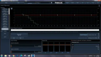

I've posted this pic in other threads, but this is an input RTA for the underseat subwoofers. You can see the crossover is around 40-45hz, which is pretty deep bass, especially for a shallow ~7" speaker.
The subs do technically work, but you really don't hear them.
