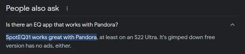

Now if I could only find an EQ app that works with Pandora...
that is not my EQ setting, just a random photo from the internets - that would be a bit extreme for me, but you get the idea ...
a Google search returned this ...
Well, it did work...and mine's not as extreme, but it does work. :)
And thanks for the suggestion; I'll check it out.
