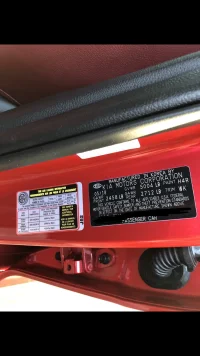

Is my build date 5/18?
Yes. That is disturbing, because that is a very late build date showing paint failure. "We" have a consensus going that nearly all of the paint failures date from November and December of last year, into early January of this year. If paint failures are showing up that recently, that means that all of the MY18s can be compromised; i.e. Kia did not fix their paint adhesion issues throughout the MY18 run.:mad::(o_O
