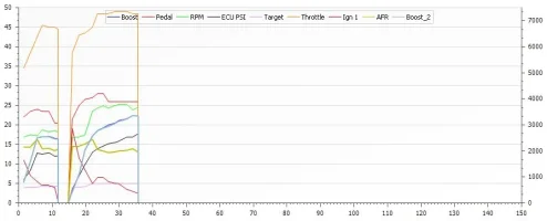

I have several of Dabears logs showing 23,24,25 PSI. ecu_psi = 20.1, target=6, Boost = 25.1. I guess the safeguards don't always work.
He also had primary down pipes aka no cats.

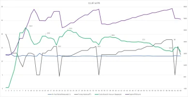

Here is a log so you can stop worrying about my 22PSI of wasted boost. My 60 foots are 1.83 so 22PSI in first seems to be working very well.
My 4th gear is pretty mellow starting at 19 and tapering to 14 PSI. For higher traps I need a more aggressive 4th gear and WMI would help do that with its 20 degree lower temps than my UP FMIC.
We revise the logic as needed. He had a unique case I haven't seen before where it's going over target at only half throttle and let off before our safety kicked in.
We've since made the over boost safety more aggressive and will continue to refine as we see more ugly logs. So if you or anyone have an ugly log especially on current firmware lets see it so we can improve the JB4 logic further!

Whoever's tune that is, damn... I wish the JB4 logs looked that good!
I will get more boost dialed into the upper gears soon, then we can start working on that 11.5/122+ quarter mile results. I have a ton of new area and maps inside the index now, and I have a lot of the dead throttle (limiter cut values) mapped, so the throttle close and inhibitors should all be addressed next time you come down.
