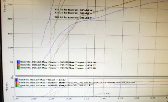

Terry just agreed the max stock boost is 14 but here is my stock dyno showing 13.87 psi. Wasn't able to find Locke's boost gauge pic showing 14 psi.

My 13.87 PSI was at 50 foot elevation in a 70 degree room so not extreme conditions.

I was in RWD mode on the dyno. But Locke has an AWD and hit his 14 PSI on the road with his gauge. He does drive it in RWD mode so I guess we may be able to get him to test that theory for science. @Michael Locke ? I haven't seen him on the forums much lately....

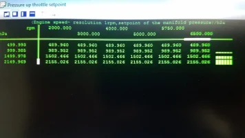

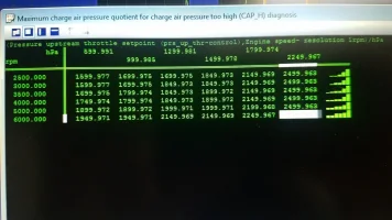

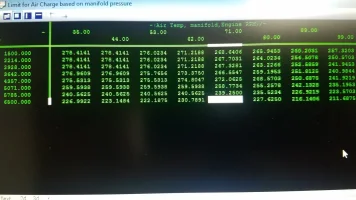

I have Terry on ignore, but have been asked to come in here and explain this.
1. The ECU is not load based, the load is not even in the top 3 for priority.
2. The ECU does in fact have target boost maps.
I shouldn't have to do this, I shouldn't have to stop a vendor from lying to the masses in this community. Why is it always me, coming in here and giving the information, taking screen shots and proving this nail bitter wrong, again?
Guys, this should not be my job. I should be able to sell you parts and you should be able to ask questions freely of any member and get accurate answers, not BMW regurgitated bullshit.
Here are the screen shots showing actual maps from the ECU identifying boost limits and target boost points. These are just a few of the maps that are actual boost "targets". The ECU uses several limits and control parameters to achieve its target boost and torque, but... it is not and I repeat not a load based ECU only.
