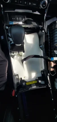

Also in my experience, at real low RPM's (climbing a hill under 20 mph, in smart mode, or very slow take offs) I would get vibrations in the center console. I have gone to the extent of padding under the console with foam which seems to have removed it.

Thanks very much for the detailed info. I completely forgot to add vibration on the center console on my original feedback.
I will try to put sound dampening on the boot floor and hopefully that would help reduce the drone abit.
So are you also experiencing the vibration in the center console?
Attached is what I ended up doing to help resolve it.
