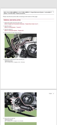

Looks like I am the next victim of leaking filter housing. I ordered housing and cooler, but I can't find the numbers for those 2 coolant lines. Can anyone help me with that?20240418_221005.webp
Looks like I am the next victim of leaking filter housing. I ordered housing and cooler, but I can't find the numbers for those 2 coolant lines. Can anyone help me with that?View attachment 85823
unless the lines are damaged there is no need to replace them
part numbers are 254693L200 and 254693L210
Awsome! Thank you! After 6 years and 130k miles it can't be a bad idea to replace them as well, just to be safe. And probably I will replace serpentine belt too. To take the belt off, you need to disconnect one of these coolant lines.

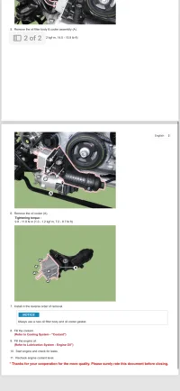

Finally did it today.
It was the gasket that is between the oil cooler and oil filter housing. Job is a pain, but you do not need to drain all of the engine oil or coolant as the manual says.
Having the front of the car up on ramps then just draining the oil filter housing no other oil will leak out. Then 2 hose clamps on the oil cooler lines stops the coolant from coming out. What you see in the pictures is whatever coolant was left in the cooler
