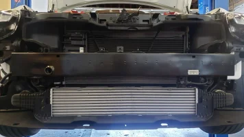

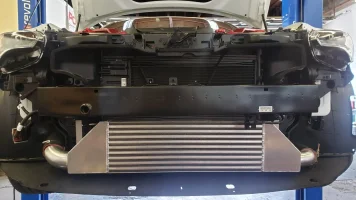

what am i missing here? By those pictures you posted (the before and after) the stock one is clearly longer and the new one is a little taller. It would appear to be a near identical IC.
