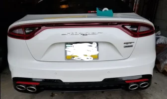

Removing the back Kia badge left paint fading and lots of small scrapes. How do I fix this?View attachment 6933 View attachment 6934
If you're willing to take off the emblem and put it on again, I'd recommend what the others suggested, polishing out the small scratches and the old emblem oval. When I did mine, I used compound followed by polish.
Also, not trying to be mean but I'm pretty sure that your Stinger badge is quite off centered.
The right side of the N and the left side of the G should be covering the holes. Looks like you made both the left and right side of the N cover up the holes or the I.

Use compound and a polisher to ge trid of the scratches and fading. If you dont have experience with polishing or paint correction, I would suggest having someone with experience do it. In order to achieve a better result you will need to remove the emblem.

I left my car in the Houston heat for an hour. Started on the rear badges with fishing line and slowly sawed back and forth. Came off pretty easy. Once off, I used goo gone to remove the remaining adhesive and then buffed it up after. Came out looking good.
