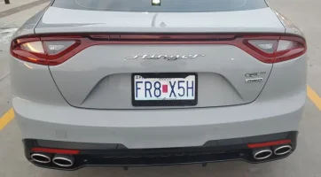

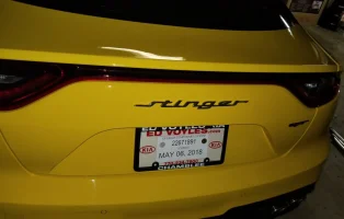

I'm having someone do my badge change on the rear & the R at the end of Stinger isn't sticking properly. Not sure if there wasn't enough adhesive, or what. Any suggestions? Stinger 2.webp Stinger 1.webp
I'm having someone do my badge change on the rear & the R at the end of Stinger isn't sticking properly. Not sure if there wasn't enough adhesive, or what. Any suggestions? View attachment 5793 View attachment 5794
Maybe tape it down after applying some heat from a hair dryer. Don’t let the paint get hot though just enough to warm it then push it flat and whack on the tape. Use a painters tape then it will come off easy.

I agree about DIY , the key issue in having the body shop do the re and re is " Show them that the rear STINGER badge is designed to cover the 2 holes left in the trunk after ther KIA oval is removed ..................also I would like to suggest NEVER use a heat gun for emblem removal , a hair dryer provides move than enough heat to loosen the adhesive and 20lb fishing line , using a sawing motion i, s all thats required to get the emblems off . :thumbup:
