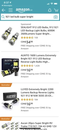

Both link provided dont ship to Canada... anyone had luck finding those somewhere else and could point out a Resourceful link for Canada?
Thanks!!
Thanks!!
Any of these should fit from Amazon Canada. I believe you just need a 921 bulb.
thanks ! I get the Auxito a try !
My biggest concern was whether the bulbs would fit. Some appear substantially taller than stock. That is one of the reason I chose the Auxito bulbs; they definitely fit.
well Iam glad you are the reference for themm ! i dont need to try them out :) Will just order them - thanks !
They work great ! I have them too !
