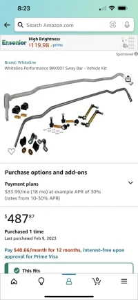

New here, I waited too long but recently installed Whiteline sway bars (if I could do all over these would have been my very 1st mod) and the front was cake but rear was a bit tight. I recommend you loosen the bracket that holds the fuel filler tube, way easier.

I bought my full kit off of Amazon
