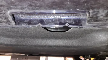

I've got the slotted runner pads for the pinch seam, its just there is very little pinch seam visible, most is covered by plastic rocker cover which is a pain as it only leaves a small amount accessible. There is only 6 inches visible and its almost impossible to get a jack and a jack stand close enough, I have butchered a scissor jack to try and get it to work.
i assume the runner pads are flush and the slot is cut into them right? Yeah, that would pose a challenge as my adapter has a pretty narrow opening allowing it to sit between the plastic and the pinch weld.
I see now what you are saying, looks like I will be ordering one of those adapters, thanks for you help.
I have the same adapter, but couldn't squeeze it in between the plastic side skirt and the pinch weld. I just found a spot along the side rail that wasn't too far away from the factory jack point. One of my jacks has a rubber pad, so the side skirt doesn't take damage. A towel would do the same.
