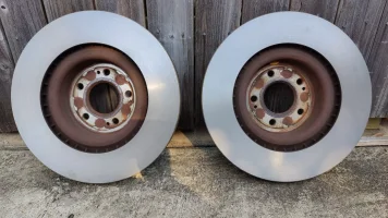

Third, a good shop takes off the bare minimum thickness necessary to get the rotors to be smooth and "square" again. It isn't much. This is my rotors after resurfacing. FYI, standard rotor thickness is 30mm. Service minimum thickness is 28.4mm. These "used rotors" still have a long way to go.
Lastly, while replacement rotor can be cheap, good ones are not. I would stay the heck away from cheap replacement, as they cause more problems than they solve. And this includes a whole of of those racy looking drilled and slotted rotors that are on sale for cheap... many of which look like they were done by job shops that have zero clue on how to pattern cross-drilling and slotting properly.
The OEM rotors are quality stock made by Brembo. If they are still in good shape, you'd be well served by resurfacing them and keeping a known quality.
