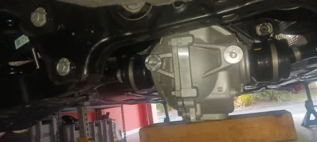

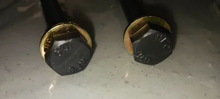

I see. Conflicted, your are. Ha hah. But you made this discovery. How long do you suppose that bolt has been missing from your differential? Was it caused by any of your disassembly/reassembly sessions? In other words, your fault from possibly over torqueing? Or did it simply end up missing prior to your ownership and you only now noticed?

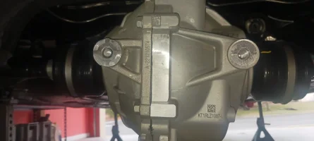

It does appear that that bolt has a very low torque spec for its size.
I can tell you with certainty it didn't unscrew, have I ever torqued it?
Dunno probably, I tighten everything in my cars every couple of years... it's good practice.

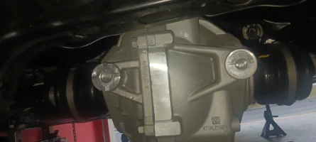

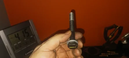

I have many pics with both bolts brandishing a marking pen stripe and they were both level..
This my chaps is the result of launching with over 6psi hence the factory limits launch control to just 1psi I would deduce.

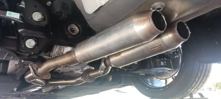

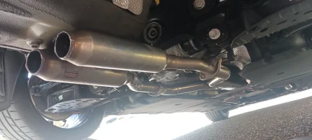

I refitted the race exhaust approx 6 weeks ago and the bolt was there then...
I am extremely hesitant to replace the bolts with a higher grade because then it will just break the diff mounting point...

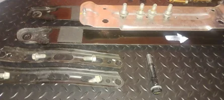

Maybe the diff brace caused it, maybe if I kept the diff brace it may not have happened...

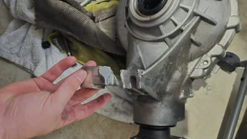

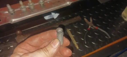

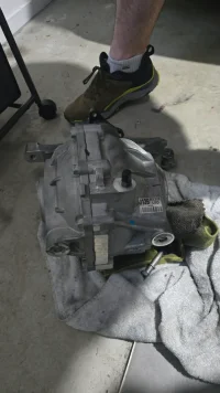

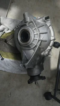

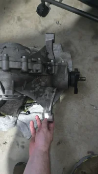

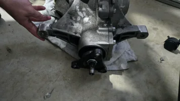

You can see in the bottom pic ^^^ up there where my bolt snapped off, the front mount is actually missing on this one 😳
You can clearly see the bolts and the markings in this pic...
Wow! Are you saying that your playing around with six times the stock boost did this? And it's one thing to have a bolt head sheer off, but to have an entire mount snap like that boggles my mind. Why do you do this to yourself?
I don't think your "Kia gave up on [you]." I think you are in danger of killing it. But, you are having fun. So, "pay to play" is your theme song, it would seem.

My favourite Kia dealer said it wouldn't be covered under warranty as i had lowered springs an aftermarket swaybar and previously had a diff brace fitted as per my previous inspection report and a NEW diff was gonna cost me $6300 plus $1630 Labor...

What are you doing with the broken front mount?
He has a couple unfortunately... I believe that particular car is up for sale and I dunno what he is doing with the spares.
Believe it or not my friend who has snapped 2 differentials now in the same spot, has a completely stock drive train and no tune !

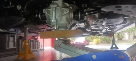

Truth be told and now I have thought about it, the amount of times I have jacked this up under the diff maybe contributed to stressing the bolts?

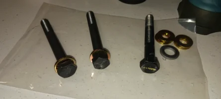

$42 each from KIA and not until the 7th Jan 2026
Ok... $8 for both, plus Hi Tensile washers from the local bolt shop thank you very much... problem solvered !
