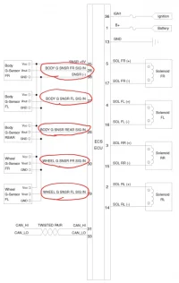

It sits too low at the rear from what i understand the sensors on the rear are confused and are dialling up sports mode suspension setting. I'll see if i can find the diagnostic report from Kia.
Interesting that the dealer would say that.
Our cars do not have "suspension travel sensors"
The is a "body G sensor" - but it doesn't know or care about ride height.

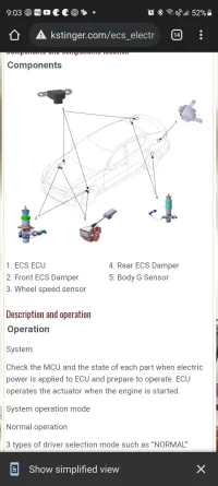

Of the 5 sensors used for the ECS....
None are "height" - Which is why lowering springs work fine with the electronically controlled suspension (ECS)
3 G sensors and 2 speed sensors
There has to be a height sensor, at least for the headlight aiming.

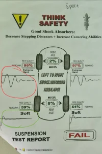

How many alignments have you gotten? Seems to me you may have a number of things loose or some bad bushings. Also I find that suspension dyno readout showing a 24% difference in the front rebound to be pretty damn concerning. Wondering if that's just the electronics getting pissy at the suspension dyno though since it's not moving in a normal fashion.

I'm not too familiar with this particular suspension dyno, but doesn't the
Sine wave reading seem to depict many bounces on the front (I would call this soft & under damped)
VS almost no bounce at all in the rear (I would call this firm & well damped)
I am not at all familiar with this particular readout, just saying what it looks like to me. Strange.
