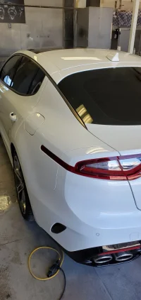

Installed the Rokblokz mud guards. I like them a lot, but they didn't include screw clips for the rear as they are under the impression it's screws holding the back wheel well cover on. It's not, it's pop clips (at least on 2020s). Had to jury rig some receiving pieces to screw into and they came out pretty great.
Edit: changed photos to show the rears were initially wrong in case someone decides to copy my goofy arse.

I didn't need to add anything for mine. Also on a 2020.
