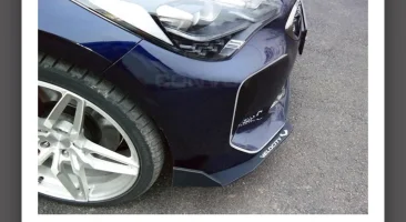

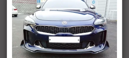

Anybody have the convoy splitter??? Looking to see if I could just use winglet.
Don’t have the answer to your question but have you considered the stingerhaus winglets in gloss black? They look great on ceramic silver.

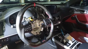

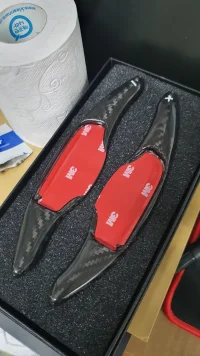

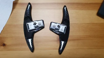

Today I installed new paddle shifter extensions.
I had the very bad idea to paint the OEM shifters in black to match the carbon fiber. I had no idea that removing that steering wheel airbag would be such a pain in the ass.
I will take a picture tomorrow in daylight, now its hard to see what it looks like.
