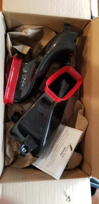

Ohhh look what just arrived! Can not wait to get them installed. :)
