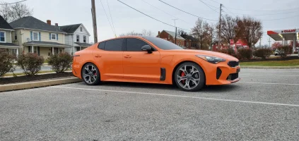

Uhhh...New Eibach Springs Install
Just installed my eibach springs today, love it!
I would also trim those bumper stocks and see for yourself if that resolves the issue, then go from there.

Why don't you go to the shop that installed your springs and talk to them? Tell them you're not happy with the stance of the car and ask them for solutions. Not saying make them pay for it or anything but they deal with suspension all day long, I'm sure they can come up with something. If not them, then another shop.

Looks great. Could be the angle, but it looks slightly lower in the back. Nowhere near as much as mine tho.
I have been going back and forth with them, but response has been slow. I think they will work with me to get this resolved. They were recommended, but it's the first time I've done any work with them so we'll see.
I carry alot of equipment in the trunk so it might look a little lower.
No it doesn't. You guys putting on aftermarket springs are like the hammer looking for a nail: and everything starts to look like a nail. :P
This is exactly the reason I went with the ARK springs, little over an inch drop in the front and an inch in the rear...sits dead nuts level and has 90% the comfort of the stock springs. The reverse rake would drive my OCD nuts, it doesn't look terrible but I definitely notice it in every picture that gets posted here or on FB where the car is running Eibach springs.
I would not run different springs in the rear...the varying spring rates would cause some ride quality issues I would imagine.
Your options are:
1. Live with it
2. Go back to stock
3. Run different springs and sell the Eibachs
4. Get spacers...you'll need to measure the spring dimensions (i.d, o.d.) and the dimensions of the upper spring perch. Off-road guys run small urethane or metal spring spacers all the time (1/8" - 5/8").

Hmm. Is it just me or is the apparent f/r discrepancy in part a function of the size, relationship to body lines, and curve of the wheel well arcs? When I had mine done, that was my initial thought... looks high in front...but then I looked at distance to ground for the rockers as well as the aforementioned wheel cutouts and decided that all was well in the world. But that's my perception, by no means am I saying @twelvexes take is invalid (and I'm on my phone so small distinctions are elusive in any case... I might peruse your pics again later when I can see them). But it sure does seem to me that the factors I mention do play a significant role. To me this is correct, to others I can see how it might look wonky.IMG_20190423_064733.webp
Hmm. Is it just me or is the apparent f/r discrepancy in part a function of the size, relationship to body lines, and curve of the wheel well arcs? When I had mine done, that was my initial thought... looks high in front...but then I looked at distance to ground for the rockers as well as the aforementioned wheel cutouts and decided that all was well in the world. But that's my perception, by no means am I saying @twelvexes take is invalid (and I'm on my phone so small distinctions are elusive in any case... I might peruse your pics again later when I can see them). But it sure does seem to me that the factors I mention do play a significant role. To me this is correct, to others I can see how it might look wonky.View attachment 34659
I understand where you’re coming from. However, I measured mine and my car is sitting 5/8” lower in the rear than the front after the Eibach springs install. Sometimes this is not that noticeable and other times it’s extremely noticeable. Just depends on how level the ground is where it’s parked. Either way, it bothers me and I can’t unsee it now. I’m going to give the ARK springs a try and see if my car has a better stance. Fingers crossed.
That sucks, hate fit weirdness. Hope the new springs get it done for you, look forward to seeing the pics. :thumbup:
That pic looks perfectly level to me. And if I had to choose nose high or nose down, I'd choose nose down.
Where did you take that 5/8" measurement again? The only way to judge is "in the flesh" of course. But pics are being posted to get opinions. So, throw a few more at us, if you are inclined to continue this game. I'm up for it.
