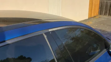

Man, I do like that black, especially since I'm looking at blacking out the roof as well. Here's a pic of my trim, the car sat outside at the dealer for a few weeks while they fixed my sunroof rattle and when I got it back they were absolutely bleached, I couldn't believe it. They're replacing under warranty.
