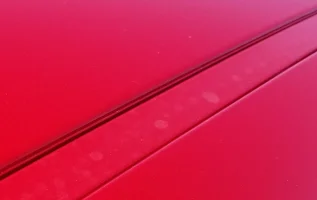

The drip rails on my 2018 have developed these spots that, depending on the lighting/temperature, will appear bright white then gradually fade a little. In the photo, you can see the new and old layers of spots that rose up from the painted rail yet underneath the clear coat. Dealer agreed to replace. Got the new "unpainted" strips. So far the new strips have been painted twice, and they still can't match the HiChroma Red color.drip rail1 reduced.webp
The drip rails on my 2018 have developed these spots that, depending on the lighting/temperature, will appear bright white then gradually fade a little. In the photo, you can see the new and old layers of spots that rose up from the painted rail yet underneath the clear coat. Dealer agreed to replace. Got the new "unpainted" strips. So far the new strips have been painted twice, and they still can't match the HiChroma Red color.View attachment 38647
Another case of HCR confounding the body shop. These cases are multiplying. Perhaps a wrap in a contrasting color would work better? Since wrapping the roof in black seems popular (and does look especially nice if you have a sunroof), perhaps that is the easiest solution?
My understanding is that HCR is a three layer paint (base, tinted clear, and clear or something like that) instead of the more standard base coat, clear coat. So I guess it makes it hard to get right... or maybe they are trying to do with base & clear only?

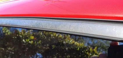

Hey guys, I just wanted to do a little DIY post to bring back your windows moldings to their original aspect.
The windows molding on my Stinger just look has dull as your's. A fiew days ago, I notice something when I scratched one of them with my nail. It look like their was a thin layer of oxidation on the molding, that makes look them dull.
So I've tried something that I've already tried on chrome moulding, it's called Compound. I've used Meguiar's Ultimate Compound. You only have to poor a little bit of the product on a cloth and scrub the molding. Try to avoid touching the rubber and bring a wet cloth to clean the compound after.
I've done this to the molding on my car and they look like brend new now ! No need to replace them.
Why do they look so dull after a year or two ? I think that this is caused by a phenomenon called oxidation, that is caused by the rain/sun/hard water/abrasive that they put on the road (winter country)/ etc... Oxidation can occurs on the paint too.
That's why it is recommended to decontaminate the paint, if necessary, polish it with a compound or a glaze and, minimum every year, apply wax on the paint. I don't think we can use wax on the molding, I would not recommend it anyway.
I've put some picture so you can see the results before and after.
Left side is done but not de ride side
Right side before the compound
Close view of the final result
