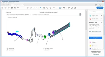

The article said that the trans cooler upgrade was a 6-row cooler. I can't tell from the photo which items in it are less than 6-row due to overlap or not recognizing what I am looking at. I would guess that the stock cooler would be 4 or 5 row (<6row).
I think I know what they mean here. Certain regions got smaller trans coolers (5 row), the US got the bigger one (7 row). In my region we got the smaller one which puzzles me because it is extremely hot were I am. Anyways, I think they had the smaller one and just upgraded to the bigger one.
