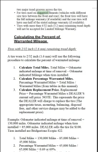

So has anyone found tires where the warranty is NOT halved b/c of the split fit?
Michelin is the only company I have found that they specifically mention split fitments as halving the warranty.
No one else specifically calls it out, that I can tell.

Tire warranties assume that you have rotated the tires at regular intervals, to maximize their life.
The front and rear tires wear at different rates, one faster than the other. The rears wear faster on a RWD car like the Stinger.
With staggered tires, you cannot rotate them front to rear. So, the fronts are always on front and rear always at the rear. The tire warranty is halved, because the tires cannot be rotated to even out the wear between front and rear.

Just looked at a random Bridgestone warranty... The fronts get the entire (full) mileage warranty while the rears get a half mileage warranty for staggered setups. At least you get the whole front warranty.;)

Though not all directly mention staggered or split fitment, EVERY tire warranty requires regular documented rotation schedules. If you don't meet those documented requirements, you will have half or no warranty.
