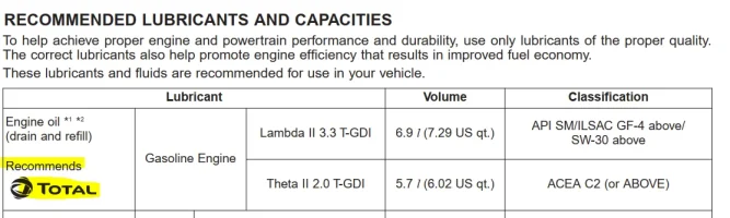

Actually, no - synthetic is not a KIA requirement for this engine per the owner's manual oil guidelines, though that is my preference as well. The Total oil in the engine as shipped from the factory is not a full synthetic either (according to Kia Canada).

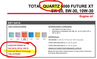

Total makes conventional and semi-synthetic oils as well. I was told by the dealer's service department that the Stingers arrive from the factory with Total non-synthetic oil in it.
yes.. it's all on the site I linked. All of their Quartz products are synthetic. Their semi-syn and conventional are called "Classic"
It may be Total conventional oil from the factory. I was simply pointing out that Quartz (which is what they recommend in the manual) is synthetic. You implied it was not.
Sorry, but I have to disagree - this is one of their 'Quartz' non-synthetic products.
upload_2019-2-12_12-19-27.webp\
Perhaps there was a change made in the 2019 or the U.S. manuals, but my mine simply recommends Total oil - nothing about synthetic.
Interesting..
I guess different markets, different requirements:
Total to upgrade TOTAL CLASSIC engine oils to TOTAL QUARTZ 5000 & 7000 series engine oils
Canada gets "quartz" branded conventional, US does not..
According to the December 2018 release that you linked, Total U.S.A is doing the same branding change - so the 'Total Quartz' recommendation you have in your 2019 OM applies to both their conventional and synthetic oils.
Maybe they'll rebrand it as 'LITERZ' outside of the U.S. ... :p
