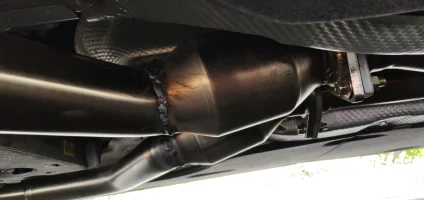

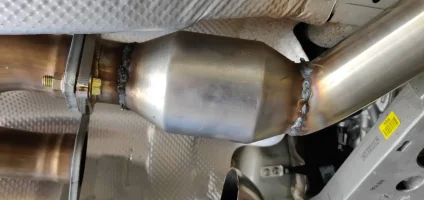

Speaking of stink, these welds stink! Haha, but at least this exhaust shop is willing to work with me - take a look. One is welded in so far...
And here it is finished.
Sound is very similar to stock, though you can hear it more while idling and during WOT.
Anyway, sorry to change the subject. But, hopefully this helps someone if they want to do the same, mostly pointless, thing as me. Haha.
View attachment 29948 View attachment 29949

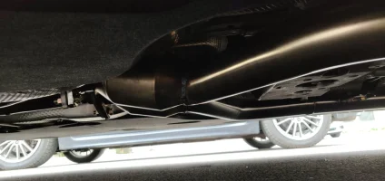

It almost looks like you're losing a few inches in ground clearance. That would concern me greatly since my car's already only 6" off the ground, so losing 2" would be a nightmare, lol

This is on an AWD G70, which evidently has a little more ground clearance than RWD Stingers and G70's, but not by much.. Even so, you're right, I've definitely lost some clearance! Even the ARK midpipes by themselves make you lose a little bit of clearance.
I figure if these things fail (ie cracked welds, or cats disintegrate), I'll just switch back to the stock midpipes. I really don't think they're much of a bottleneck.

Those welds look janky as hell. Not bad, per se. But sheesh.

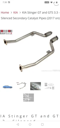

Has anyone seen the quicksilver silenced downpipes out of the UK?
Go to quicksilverexhausts dot store and then search for stinger ~$700
Ill try the ARK DP first because i like the sound of the CB exhaust and the pair sounded nice from what I heard. If I need an alternative this is one option ill consider.
