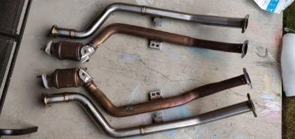

So, installed some ARK midpipes yesterday and attempted to have some magnaflow 200 cell HFC's welded in place of where the stock cats were, and no go... Not enough room... Damn. Just like you said. Even though the HFC's are relatively short, still can't quite get them in there - or at least this exhaust guy wasn't even interested in trying.
Side by side pic.
Side by side pic.
Yea, the factory secondaries are designed very specifically to accommodate cats, and you'll have to lose ground clearance if you want cats on aftermarket ones in which you'll have to put them closer to the front of the piping where it leads up a little. That's a bit close to the primary cats, but if you wanted cats on both... meow?
Problem with putting them on the upward angle where it's close to the primary cats is that you can no longer access the flange bolts. Also, there isn't enough clearance on the body, it would hit the floorboards.
Anywhere else along the midpipes there just isn't enough clearance against the body. I think the only option is in the factory location, but even that is really tight due to how the ARK pipes are bent. They could have bent/angled them differently to allow the HFC's to fit, but... I don't know.
