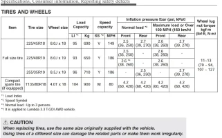

I am hoping for a little advice on a second set of wheels, particularly as the availability in the US is scheduled to start with the need for winter tires on a GT 2 (?) in the northern climes.
Below are the wheel and tire specs from the owners manual and here are specs for 4 wheels I have available from my 2013 Mini Countryman 4S.
I am wondering if these would be compatible/acceptable given the Kia specs-GT 2 preferred. To me it looks like front maybe yes, rear maybe not, but I'm not sure about the offset and and not expert on wheel details.

View attachment 1083 View attachment 1082
I don't believe the bolt patterns match. So they would not fit.
