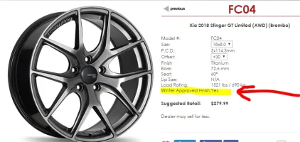

Just a fair warning to you that with the machined face of the OEM wheels expect to see peeling clearcoat from salt within 2-3 years. You might be able to use a really high strength wheel wax to help prolong the inevitable though.
Are you saying that the OEM wheels are susceptible? What about any other wheels going through winters? How does one go about picking a spiff looking "winter wheel" that won't peel?
Manufacturers designate certain wheel designs for winter use, including the FAST FC04 above - you'll notice it doesn't have exposed machined surfaces, which only have a thin clearcoat for protection.

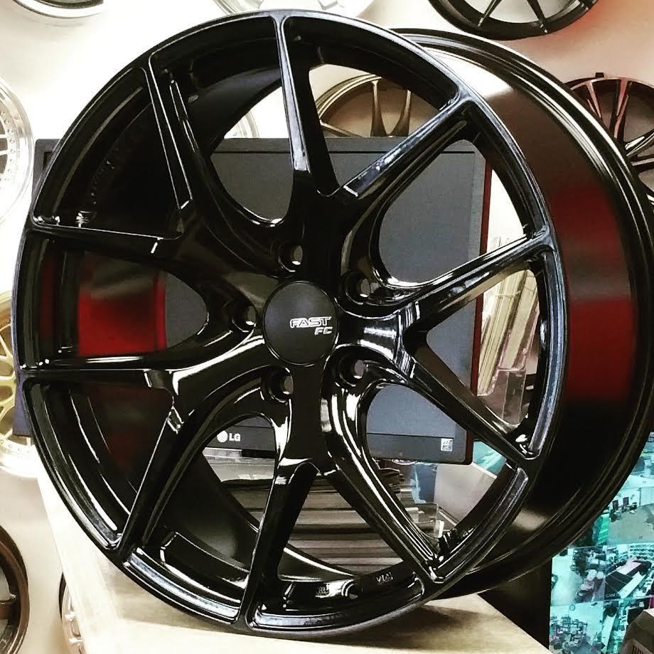

Ended up settling on the Ice-X xi3 with the FC04 in gloss black. I'll post pictures when installed.
Nice rim choice!
I'm assuming the offset takes care of clearing the Brembos?
