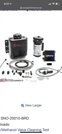

Well this sucks. I couldn’t figure out where Snow’s MAP sensor connected to the engine bay and I called their support and they said it needs to read a positive boost pressure which makes sense, however my UP IC doesn’t have an 1/8 hole for their MAP sensor so now it has to be removed, drilled and reinstalled. The only potential 1/8 hole is for the vacuum. Unless someone figured out how to use this location for both MAP sensor and vacuum?
As a follow-up, what is meant by this?
However, the fact that the vacuum line has to be slipped over the vacuum line coming out of the controller and ziptied over it is a little janky

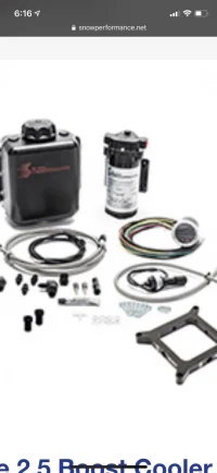

Looks like the issue here is that most folks received the VC-50 controller and I received the VC-30. Would be interested to hear if anyone received the VC-30 and did you simply attach the MAP sensor to a bung in the charge pipe and since it simply pushes into the bung as it’s not threaded did you zip tie it to the charge pipe to hold it in place.
Sorry for the numerous posts. I was thinking my bungs were 1/4 when in reality they are 1/8. This looks to be my best bet, but then the controller will have to be installed in the engine bay.
To clear up confusion this created for me and maybe others. If you have this VC controller which is VC-50 you have the Stage 2.5 and not Stage 2. I have a stage 2 and it includes the VC-30 with a MAP sensor that should be connected to a 1/8 NPT bung on the charge pipe to read boost pressure.

Here is the Stage 2 with the VC-30 controller.
