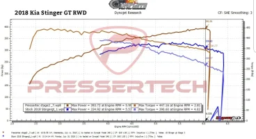

No, they’re not anywhere close to those gains and they’re actually being a little deceptive with their hp/tq comparisons.
Their 459hp/522hp vs 365hp/376tq is an untrue comparison because they are using Kias very underrated factory numbers. Their own dyno and tons of others dynos proved about 395hp/460tq=335whp/390wtq from a completely stock Stinger.
Their actual dyno comparison for the Stage 2 tune shows gains of only 59whp/56wtq and that’s with K&N high flow intakes. A piggyback Stinger with only intakes & 91 octane fuel gains 89whp/123wtq or 113whp/128wtq with octane boosters/e30. That’s about double the power gains at half the cost.
This is actually a very mild tune because Kagantuned’s Stage 1 ECU tune gained up to 94whp/134wtq with absolutely no other performance mods. He expects about 430whp+ after adding intakes, and his tune only costs $750(Kia Stinger GT 3.3TT Stage 1 Tune)
Don’t get me wrong, Pressertech is a very reputable high quality tuner, but the facts show that their tune is the most conservative & lowest powered options available at this time.
Sorry, but you are wrong. My stock whp was 316.
Peak power gains aren't everything and aren't the end-all to actually making a car faster.
Sorry but I’m not wrong.:rolleyes:I never said “all” dynos, I said tons. And didn’t you use a Mustang dyno, not the usual dynojet?
Most stock Stingers dynojets are between 325-345whp and that includes the top tuners & manufactures results from Pressertech, BMS, Tork, Stillen, K&N, KHARTUNERZ, etc. Look them up and you will see that around 330whp is the standard, and what the most reputable sources show.
I agree. As others have said the “power under the curve” and the wider higher torque curve usually makes the quicker car. Unfortunately Pressertechs tune is down about 50-70wtq across the whole power band vs Kagantuned & top piggybacks which most definitely means less performance.
No, I used an AWD dynojet. You are wrong about the @pressertech tune and the power it puts out.
If it's fast that's all that counts. Dynos vary and don't mean much.
Well, according to PRESSERTech themselves they actually only replaced the OEM filters with K&N flat panel filters - it was still using the stock intake.
Taken from their blog...
The only difference from Stock that we adjusted is a K & N High Flow Air Filter.
...even so, I still get what you're saying.
