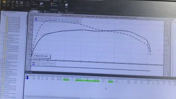

Just called the Dyno place and last years was over laid the 2019 on the run today but the lowest numbers as this afternoon s run :)
why does the dyno have 4/4/2019 date?
The 2nd run selected (displayed below the graph) has today's date and that is where the 330WHP/406WTQ figures come from. Also, his dragy time can't be due to the wrong dyno graph so unless he just isn't paying attention and uploaded the wrong picture there, it all adds up to something being wrong with the tune or a major bottleneck.
There can be nothing accurate about a Dyno of this car in 4th gear. 5th gear is 1 to 1. You need to discard everything about today's printout.
I'm willing to accept that the dyno numbers could be wrong because of dynoing in the wrong gear, however, correction factors exist to deal with variables that can't be controlled so I hope the dyno operator took this into account.
Also, this still doesn't explain his STOCK 0-60 and 1/8 mile times achieved and measured today with Dragy.

None of it really makes sense but as long as you're happy I'm happy. My advice to anyone on the internet, if you are doing dyno testing to get numbers, rather than evaluate tuning changes on the fly, accept nothing less than a dynojet. Anything else is a waste of your time and money.

Dyno brand matters less than comparing like for like. Best thing to do is always dyno your vehicle at the same shop.

If you're doing same day testing between different maps and focused on % gained rather than actual numbers then any dyno will do. I prefer MD dynos for that purpose. But for 98% of what anyone on this forum is going to be doing, it has to be a dynojet.

Also the DA on his run was +2500. That and 91 octane isn't going to be blazing fast.
