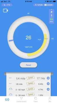

Ok I just got the gas and windshield washer filled to the top , spare tire on board and, with my wife with me and decided to try a Dragy launch 0-60 and 1/8 mile run ! The Pressertech tune check out ok and tomorrow looks like I can get a run Dyno In the afternoon:) 79EEC097-81C2-43CB-9507-1C5C0D621035.webp
Ok I just got the gas and windshield washer filled to the top , spare tire on board and, with my wife with me and decided to try a Dragy launch 0-60 and 1/8 mile run ! The Pressertech tune check out ok and tomorrow looks like I can get a run Dyno In the afternoon:) View attachment 38922
Click on your 0-60 and show us your graph, also, you should do a proper 0-60 w/out passengers and show us.
This is supposed to be a dyno thread. Since there is only like 1 Dyno in this ENTIRE thread, the least you could do is show us a decent 0-60 run on your PRESSERTech tune! Lol

What was your pre-tune 0-60? What kind of tires you running?

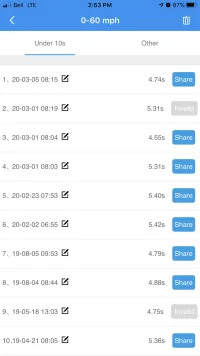

This is some previous runs

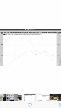

This another Dyno run from last with the piggy back 58CE76B8-5E4D-4033-B8AF-AE5B32F0AD94.webp
