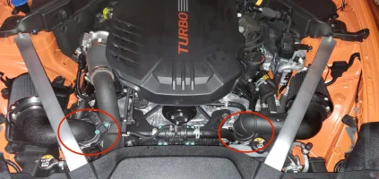

I have the bottom in on both sides. It is definitely snug once the strut brace is bolted back in. It is literally the only positioning it would fit. I posted the pic above
How did you get it on? I tried and it was not going back in with the strut brace fitted.
I loosened the bottom portion of the stock intake as well and turned it so you can position everything differently. I rotated them so the filters fit farther down into the box. I circled on your picture what i loosened and then turned. Take a look at my picture a few posted back, you can see how they are angled differently

you can see how mine is angled more towards the front of the car, yours is pretty much 90* You can tell that the attached hose is less kinked as well because its extended farther (dont pay attention to the red circle in this pic lol not what we are looking at)

You have a Pic with the strut on?

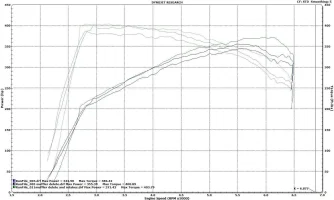

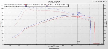

I’m not sure if I’m following you correctly. Are you saying that intakes are great or they don’t add any power?
If the latter here’s a few dynos showing about 15-25whp across the whole rpm range and some show even better gains near redline. Torks gained 44whp at 6100rpm after adding intakes.
6E9E3832-607D-4787-A116-A8BE7172B672.webp A91573BE-1DA6-43FC-9407-242C408A3F9F.webp 73BD0CE1-498F-4A09-9BC6-373E2D0D840D.webp
There also many people showing about 0.2sec drops on 0-60 & 1/4m times so there is no doubt that open air high flow filters make a big difference.:thumbup:
If you relieve restrictions on your intake you're going to gain horsepower/tq. no matter what, some people say just putting in drop in filters replacing the OEM filters is the best way to gain horsepower through the stock intake which directs cold air over the filter. This is not accurate. The airbox itself and filter surface are restrictive even with no filter in place. So removing the air boxes and putting on a filter kit with a heat shield will be hands down better then the stock air boxes. And I've measured the air inside the engine compartment while the car is moving and it's around 70- 90° nothing that is going to drop horsepower vs. Airflow.
You only make more power if, ‘if’ you need more air. The dynos provided are vendor based. I want to see a car run on map 1 jb4....change the filter set up and run again 15 minutes later and make power. There have been no private dyno sessions posted here in the last 6 months that I’ve read where we see the curve climb at all. Lately a newer member actually showed a slight loss. Horsepower factory did a comparison and gained only 3hp....cat back was 10.
