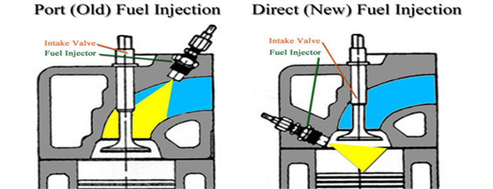

True. Why? Good question. GDI engines in particular are susceptible to build-up in the intake systems (particularly around intake valves) because they inject the fuel directly into the cylinder rather than into the intake airstream, and there's no flow of fuel over the valve stems/seats/etc to wash them clean and cool them (hotter components lead to more oil burn-on) as there is in a port-injected engine.

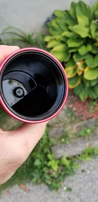

* Oil catch cans DO catch oil.

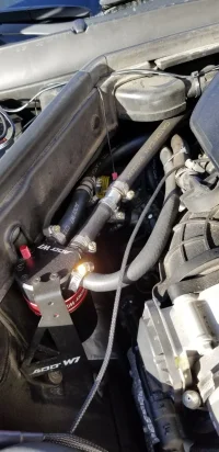

Well designed ones do, yes, and how much they catch depends on how well they're designed. Then you have the difference between a catch-can (that captures the oil and requires draining) and an AOS that generally captures the oil but delivers it back to the sump.

* oil catch cans are NOT installed by authorized Kia dealerships and WILL void the vehicles mechanical warranty
I cannot agree here. Some dealerships WILL install them. Adding a catch-can (or AOS) can only void warranty for an issue directly impacted by the installation of the catch-can/AOS. Kia cannot refuse a warranty claim where the catch-can or AOS did not contribute to the failure.

The fact that catch-cans are catching oil at all is proof that they're doing something - there's no place for oil in the inlet system of an engine (GDI or otherwise) - if it did, they'd inject it there on purpose. Oil ends up in the intake system of engines as a byproduct of compromises in engine design and engineering - it's possible to stop it (or reduce it), but the cost of doing so (in terms of efficiency, engineering efforts, etc) is substantial.
It's well know that oil in the intake system causes build-ups of burned residue, it's well established that the issue is worse in direct-injected engines, and the cost of remediation of such issues is significant (often requiring the pulling down of the entire intake side of the engine and cleaning/replacing of parts - assuming it doesn't cause other issues such as component failure due to a number of likely scenarios. It's also well established that the oil that doesn't build up inside the inlet system can only go one place - the combustion chamber, and it's known to have a negative impact on the efficiency of the combustion process (it effectively lowers the octane level of the combustion charge, meaning hotter and less well controlled combustion, requiring pulling back of timing resulting in less power being produced).
