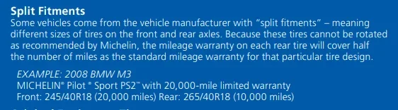

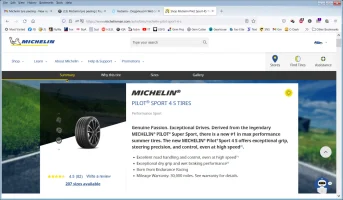

Pretty sure is 30,000 kms. Not milesMine did that on the rear BAD and the front just starting at 16,000 gentle miles. No turning stopped, no track, no wheelies, highway use. They were rated at 30,000 miles for tread wear and had lots of tread left, so Michelin gave me 49% off 4 new tires and Discount Tire had sale discount, old people discount, etc. so the new set of 4 was $618. I was okay with that. First time I ever had any kind of a problem with a Michelin tire. . . . . .
just looked up some other brands as well and it looks like they pretty much all state only rear is halved... but i'm pretty sure in the past, i've seen where it was halved for both axles on staggered... must have changedInteresting. My understanding was half mileage for front and rear since neither can be rotated to the opposite axle.
My GT2 came with pilot sport 4 S. Michelin didn't quibble at all, since the mileage was ~~ 51% of 30,000, they allowed 49% on all 4 new tires, although the rear were really bad and the front were just starting. Fortunately Discount Tire were great and had several other discounts going on, so I was quite satisfied that it was fair.Pretty sure is 30,000 kms. Not miles
From Michelin Pilot Sport 4 Tires | Michelin Canada
