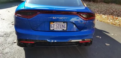

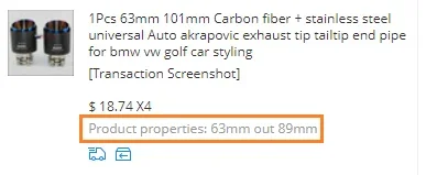

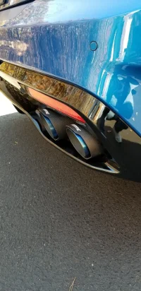

The ones I ordered and slipped on like a glove (both on the SS MBRP exhaust pipes and in the bumper) are the following:
US $19.84 19% OFF|1Pcs 63mm 101mm Carbon fiber + stainless steel universal Auto akrapovic exhaust tip tailtip end pipe for bmw vw golf car styling-in Mufflers from Automobiles & Motorcycles on AliExpress
Exact size I ordered was 63mm X 89mm.
So you didn't have to trim off a bit of the bumper to squeeze these in? Do you have any photos by any chance?
Purchased my tips of Ali. They fit like a glove. Not sure why we’re still going in circles here. So many folks have purchased and verified fitment.
