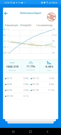

This was my 60-130 a few months ago. Jb4 Map3 30% E85. I have intakes muffler delete and secondary downpipes.
not too shabby.
Good!

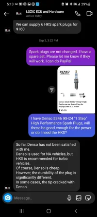

Is anyone using denso plugs with their lozic ecu? I know HKS is recommended but the price difference is considerable.
I see the denso 6 pack for $65 and the HKS M45s for 6 pack for $150. I don't know man, maybe it's just me, but if I am spending a few grand on ECU, TCU, AWD tunes, you would think the extra $85 would be irrelevant to make sure my engine doesn't blow up.
I see the denso 6 pack for $65 and the HKS for 6 pack for $150. I don't know man, maybe it's just me, but if I am spending a few grand on ECU, TCU, AWD tunes, you would think the extra $85 would be irrelevant to make sure my engine doesn't blow up.
Yep, this is me exactly. Seems he tested both, but recommends the HKS. I've got only a few hundred miles on the plugs since install, but no CELs.......yet.
