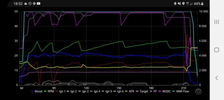

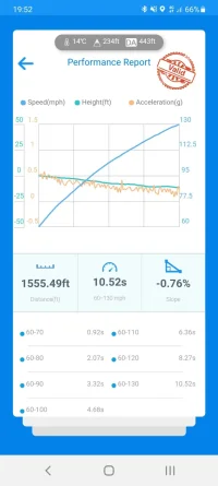

Some tuning today... and also a 60-130 run
Screenshot_20210925-185249_JB4 Mobile.webpScreenshot_20210925-195240_dragy.webp
No idea what a good 60-130 time is. How does yours compare to a stock Stinger? And vs other cars normally compared with Stingers?
Hopefully someone in here with Lozic or JB4 have done some runs. Would be nice to compare.

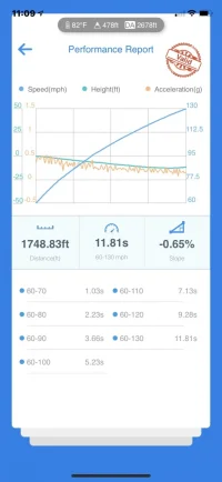

I got up to 130 the other day but it was a spur of the moment thing lol. Only done that a handful of times in 2+ years.
I was thinking the same thing, what is a good 60-130 time?
ha, just looked on my dragy and I had one saved. This is with mods in my signature, except before I added the intercooler. DA was a bit high as it was warm and a bit humid. I'll try to get another one. Running map 7 with Meth, etc. full interior, but minus the spare tire. Intake air temps on this run were mid 90 degree range.
Good to see! In a long run like this both a good IC and some Meth can help.
