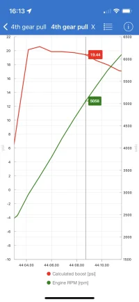

I’m actually thinking I might received a 1.4 bar 93 or even 91 tune instead of a 1.5 bar 93 tune. That might explain why I’m slower than all off you guys. Here’s my boost curve, none of your 93 1.5bar guy’s log has boost this low on high RPM so it might be something wrong with my tune. Peak boost is right at 1.42 bar.
which app/device is that on your graph photo

Car scanner pro and any obd2 bluetooth reader should work. Make sure to select only pids that you’re monitoring or it will overly stretching the sampling frame for all pids to make the log unreadable.

It’s not a 1.4bar on 91. I have a 1.4 bar on 91. In 4th gear at 5,000 rpm my boost is always 17.5-18.2

what’s your peak boost tho? Then it might me 1.4 93 if it matches yours.

Ah okay, which option did you select for the graph? Is it the "live data"

It has hit 21.2 before but that hasn’t happened again. My most recent log and the 5 before that ..peak boost is 20.2-20.7

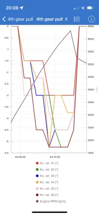

Just choose knock, knock retard for each cylinder, advanced timing boost and some other pids you’re worried about then that’s enough.
Then I’m sure I’m having a 1.4 bar tune now. Peak boost total matched yours.
So curve is probably like 1.4bar on 93 instead?
Yup that’s what I’m thinking and my 1/8 and 1/4 shows slower than expected too.

He said it’s 1.5 bar tune, but it didn’t reach target boost for some reason and he’s trying to fix it now. No wonder I’m slower than all you guys haha.

I hate that log format. Wow. Disgusting! The numbers dont seem to bad though.
