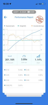

Just did this hours ago. Not even close to you guys haha. High DA is killing it for sure but since my tires freaking out for launch above 2500rpm, the power is definitely there but my tires are not hooked. 255/35 r20 square indy500.
