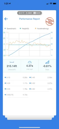

A few days after installing Ark catless midpipes & Magnaflow catback, I got my best time to 60MPH so far, with a full tank of gas. Temps outside were about 50 degrees F. When it was stock, my best time was 4.55 seconds, and that was with less than a gallon of gas in the tank and temps in the mid 40's.
but its safe to use 87 and not damage anything ? cause it is our option whether we care the 365 pony's are available on an everyday drive where I am not racing in lemans ?
If your car is 100% stock and IATs are low 87 Octane will act exactly like 93 Octane in the V6 Stinger.
Someone that used to post here swore midpipes made the car slower. Your post might be the first to document improved performance from them. The folks at Ark would probably be interested in your testimonial.
But he installed a Magnaflow catback at the same time and we know Stingers muffler are restrictive and give HP so I do not believe this prove anything for the mids.
Yep, not sure if it was one or the other or both, since I installed both at the same time without any individual testing. I did the midpipes & catback mainly for sound, but it was nice to see the little gain.
...if the catless midpipes actually make the car slower, it does make me want to try running it with the stock mids and Magnaflow catback. But I worry the Magnaflow would be too quiet on its own. Then I'd have to put it all back together again.

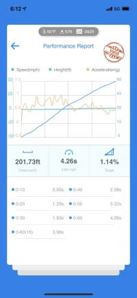

5D335743-2AB6-4144-B221-19AE7724126A.webpThis was my time Saturday Jb4 map 2 secondary cat less downpipes muffler delete and intakes. Also my first time using the draggy and timing my 0-60. Looking to better it lol.
