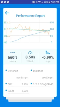

I did get an invalid run....last run launch control fizzled out on me as I left the nose dove down a bit but then took off on a crappy run invalid 4.92 0 to60 -2.06% slope.
but a valid ..8.50 1/8 -0.99% slope 88.46 mph this was run 3 so I guess you can have an invalid0to60 within a valid 1/8 run....so why the big slope deviation?

so run 3 you have it was invalid on the 0 to 60 because of that wild slope but valid in the 1/8

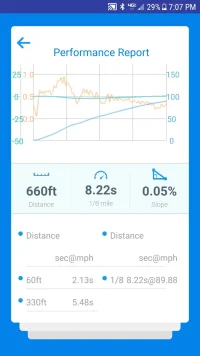

run1 map2 Draggy Sez.....8.22 1/8 0.05% 89.88 mph 2.13 60ft 0to60 4.64 -86% slope

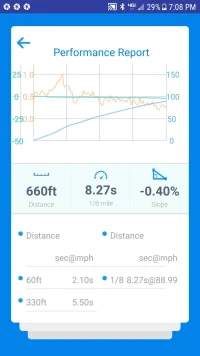

run2 map3 Dragy Sez..... 8.27 1/8 -0.40% 88.99 mph -0.40% slope 2.10 60ft

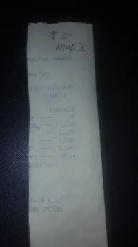

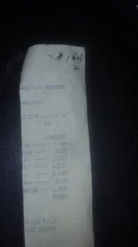

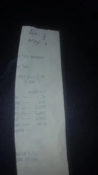

heres the 1/8 mile draggy runs....the 0to 60 are in another folder on draggy...so after posting Draggy ill post up time slips...they gave me yellow copies hope yall can make em out...ill try to edit and give them more brightness.... maybe some one could arrange the slips and Draggy for better comparison? Wash run 1.webp run2.webp run3.webp
they are in order left to right 1-2-3 last run it was the ol launch control boogering me
my screen shot cut off the valid run...they are valid ill post that part if yall want....okay lemme get the slips in order
20190127_222816.webp 20190127_222924.webp Okay heres the slips 20190127_223013.webp 20190127_222816.webp 20190127_222924.webp 20190127_223013.webp
Sorry for dupes new phone lol 0 to 60's coming shortly Wash
Top to down is 1 2 3
View attachment 19053 View attachment 19054 Okay heres the slips View attachment 19056 View attachment 19053 View attachment 19054 View attachment 19055
