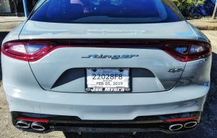

I did the rear trunk emblem with paint wedges and came out perfect. Never receive advice from Audi owners like my ass of a lil brother, lol. But this is how it came out IMG_20181222_150131_751-01.webp
