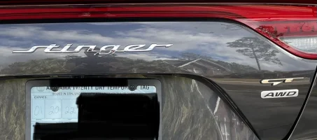

Did a debadge of the Stinger, GT and AWD emblems. I think It looks much better.

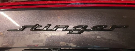

I just replaced my badges. Removed the chrome and replaced with gloss black from KDM. Easy peazy
To prep, I outlined the the original chrome badges with painters tape. I got that idea from KDMKurt on YouTube. This ensured I placed them exactly where the old ones were. I then used thin fishing line. I slipped it underneath and then began sawing up and down while pulling slightly away from the car. The line broke a couple times but it worked well. After that i removed the ”glue” using goo-gone. Then cleaned the area with isopropyl alcohol before placing the new badges on. Remove the painters tape and now it looks like it came from the factory. Then reapplied the ceramic coating over them and the surrounding areas.
there are no holes under the logos.
Im going to replace the front logo after the front is wrapped with PPF and then install the new gloss black KIA logo on top. simpler than cutting around it.
note: the Stinger logo is actually 2 pieces. I didn’t read the product description carefully enough. No big deal just be aware. Unfortunately I should have been 1mm more precise when applying the new one but I’m pretty much the only one who notices.
I also added ”stinger” to the door sills. I think they too also look factory.

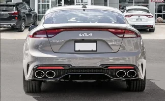

I think I would screw up my car doing it myself. I would take it to my mechanic.
But if I got the big Stinger script for the back, I would remove the small Stinger that is currently there on the side of the back - what would remain if that is removed? Wouldn't there be holes, etc?
I procrastinated for almost 2 years before finally getting this done. The original badge popped off after only 5 minutes but it took over an hour to get the tape off. I tried the Goo Gone gel but it just wasn't doing it. Don't cringe but since I'm old school I resorted to Varsol. Don't worry there's no damage to the paint. I had a bit of a shadow in the clear coat which mostly polished out but there is a bit of a mark you can still see at certain angles. They must put those badges on when the paint is still soft.
I know I have lots of swirl marks from washing it. I'm going to get it polished when the weather warms up some more. In the end it looks pretty good I think.
What remained when you removed the small Stinger from the back?
