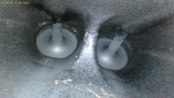

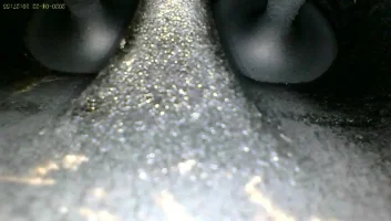

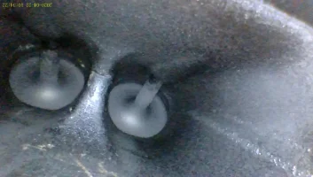

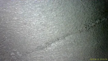

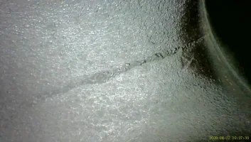

Here are the endoscopy pics, not sure which bank this is.
