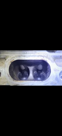

My valves after 70k miles just before walnut blasting. BMS catch can was used only starting 50k miles. Fuel injectors were also tested and their condition was perfect. Had some roughness during idle, would see if it went away after blasting.

Any after shots?
Those look pretty nasty.

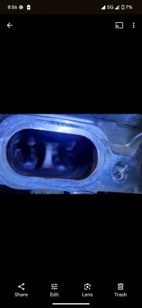

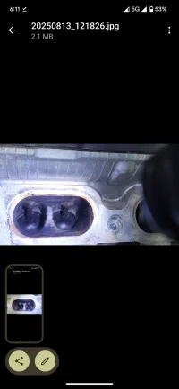

I like more pushing hard from the stop than high speed in highway :) from now will try periodically to use valves cleaner to maintain them clean.

I'm assuming that's after? Also, how much is the walnut blasting?
Correct.
I am located in Europe, probably the price I've spent won't help much. It's about 320 euro.
