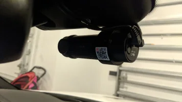

Installed the BlackVue dual channel system. Mounted the camera behind the mirror and below the LKA camera. Mounted the rear camera on the read window, just below the rubber trim.
Routed the wiring under the rubber door trim and behind the headliner along the windshield.

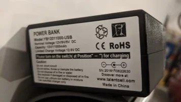

I then connected a 11,000 mAh rechargable battery. The battery will power the dashcam for up to 18 hours should should the Discharge Prevention Device activate.
I placed the battery in the glovebox. I mounted the discharge device under the driver's side dash, just above the accelerator pedal.

Mounted mine in the same place. Did you run the rear camera yet? Still need to do mine, but I suspect it's going to be a paint in the ass
