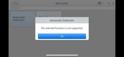

I tried following these steps and got a notice that it’s not supported. Any suggestions?

Go to manual selection and select 2020 Stinger and do it that way, I heard someone else say they had the same issue.
Its the same engine and transmission, the 2022 just hasnt updated yet to support it.
That was me, a week or so into January. They came back and said 2022 had been added, and I'd assume 2021 as well (they're probably all identical), but I had returned the unit by then, so maybe someone else can confirm.
Bought device this week for 22 Stinger GT. Updated all software. Can confirm still had to use 20 profile, not 22. Worked fine with 20 profile and shifting so much better on coasting to a stop.
