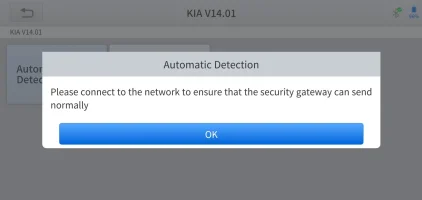

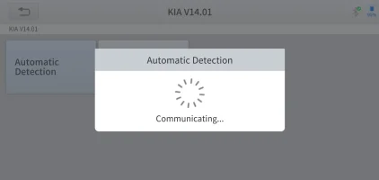

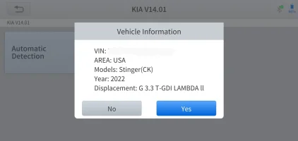

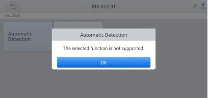

I just had it do all 90+ updates, Kia or otherwise. Pretty sure it's not a connection issue because those ran fine, the ODB unit blinks when I run something, and it finds my make/model/VIN during the scan. Screenshots below.

I've tried on both wifi and cell service (both of which seem to be fine), both Auto and Manual car detection. The one step I don't have a screenshot of, because it appears for less than a second, is after the VIN and "make sure you're connected" screens, when it goes to the "Communicating..." step, I get a split second of something like "Going into the system" before that "not supported" message.
Very odd. After that screen, it should bring you here with the red circled option that you need. You activated the A30D and created a password and all using the code printed on the little insert right? It almost seems like a licensing issue for your XToolView attachment 84109
If still having issues, maybe reach to their support. Only other idea is that maybe the feature isn't supported for yr 2022 yet, but that would be kinda odd. Works perfect on my 2020 stinger 3.3.
I never make it to this screen, just goes from "Communicating..." with the spinning icon, to the failure message after a couple of seconds. I created the login when I first opened the app...don't think it will let you do anything (including the updates and 33 step AutoScan that work for me) without it. And I don't think 2022 is the issue, because some of the other screens where you can look up vehicles by region only display certain years, but in the Manual screen of Gearbox Match it offers me the 2022 option.
Ya, I noticed your VIN wasnt showing...maybe thats why it wont work.
Can you get it to see your VIN?
I just covered it, it does retrieve it

So turns out I was wrong to assume that the years listed under a given feature indicated which models were available -- they emailed me back saying Gearbox Match isn't available for 2022 yet. So I went into the Manual selection and tried 2021, which failed with the same error, but when I tried 2020 it completed successfully. I assume it's the same flag or table that gets cleared out so year doesn't matter.
Went on a quick 5 mile drive and didn't notice any 4-3 or 3-2 lurching across a few drive modes (basically only got 1 full stop apiece). Will see how it behaves over the next few days but seems to have worked.
